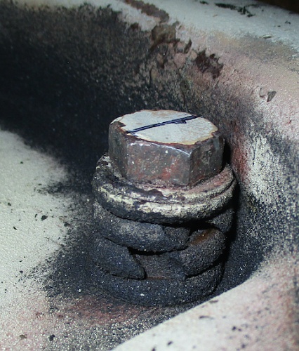

Hi All
Well as I think everybody suspected the problem is in the tension spring on the adjusters. So I will be ordering some replacement springs.
Name:	Trailing Adjuster before.jpg
ID:	108682Click image for larger version
Name:	Trailing Adjuster.jpg
The rear most or trailing adjuster once the brake shoe was pulled back could be turned by hand with almost no resistance. Once the end was ground off so the adjuster could be remove revealed the spring was broken.
Name:	Leading Adjuster Before.jpg
ID:	108684Click image for larger version
Name:	Leading Adjuster.jpg
While the forward or leading adjuster required 25-30 ft.lbs of torque to turn, but on close examination it was discovered was broken into 3 segments.
Name:	Trailing Shoe Full.jpg
Take a look at the brake shoes, these are the original shoes mileage 24844.
