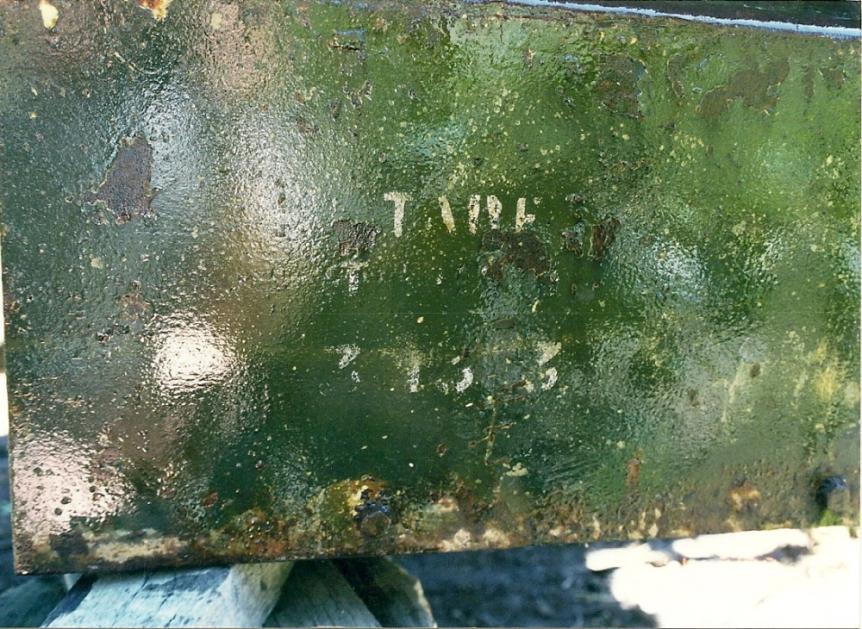

Tonnage and Tare on the out side of the fuel tanks. (TARE 3 tons 13 cwt 3 lbs.)
And other stencil’s in other places.
