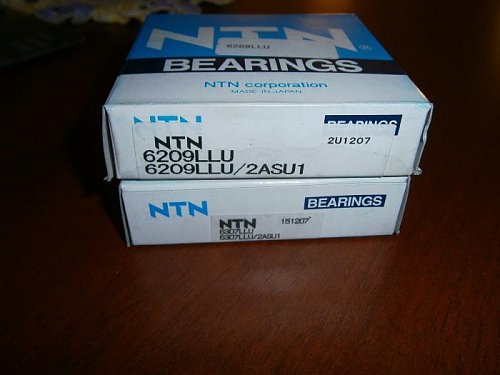

Yesterday I called into the local bearing shop, and asked about the BB7025 & BB7065 bearings I want for the gearbox MDG shaft. In the past, these fellows have managed to find what I need........usually. To be quite frank, I expected the standard search on computer, followed by further enquiries via phone to their suppliers, over a period of days. Sometimes it's fruitful, sometimes not. When I gave the part numbers yesterday, they checked the computer then walked away to the back room.............and came back with both bearings!
Name:	New transmission MDG bearings shielded both sides.jpg
ID:	55647 Click image for larger version
Name:	Ford BB7065=NTN6307 and Ford BB7025= NTN6209.jpg
Now, these modern bearings are shielded each side, which the guys indicated would provide better protection against oil leaking past the bearings and out along the shafts. Sounds good! Anything that keeps me from having to look at future oil stains is alright by me.
