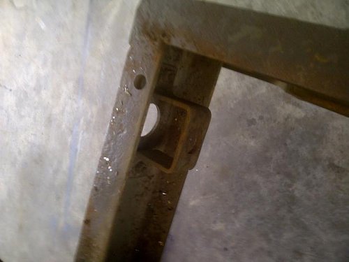

Inside detail of the left rear light.

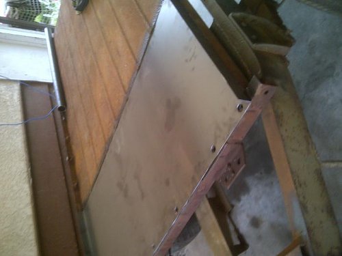

Replacing the front portion of the floor, I can't duplicate the ribbing so I went a gauge up to make up the rigidity.
