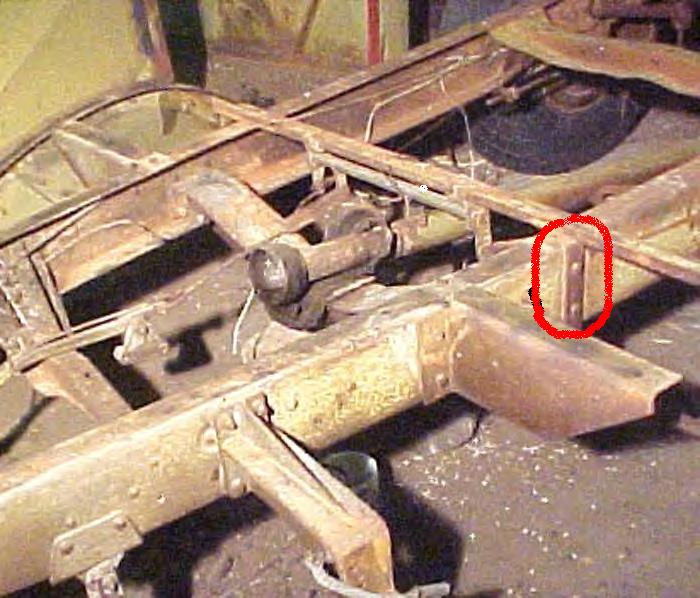

Pulled out my fuel tank brackets that came with the truck today. They had been shortened to mount one tank under the 2B1 bed that was installed when I got it.
Enlarged all of the photos posted,(thanks again), and got my head around the linkage layout.
Was the linkage mountings welded directly to the front fuel tank bracket? Neither of my brackets have any evidence of anything being cut off. The frame doesn't have the mounting holes circled in David's photo. Am I missing something else?
