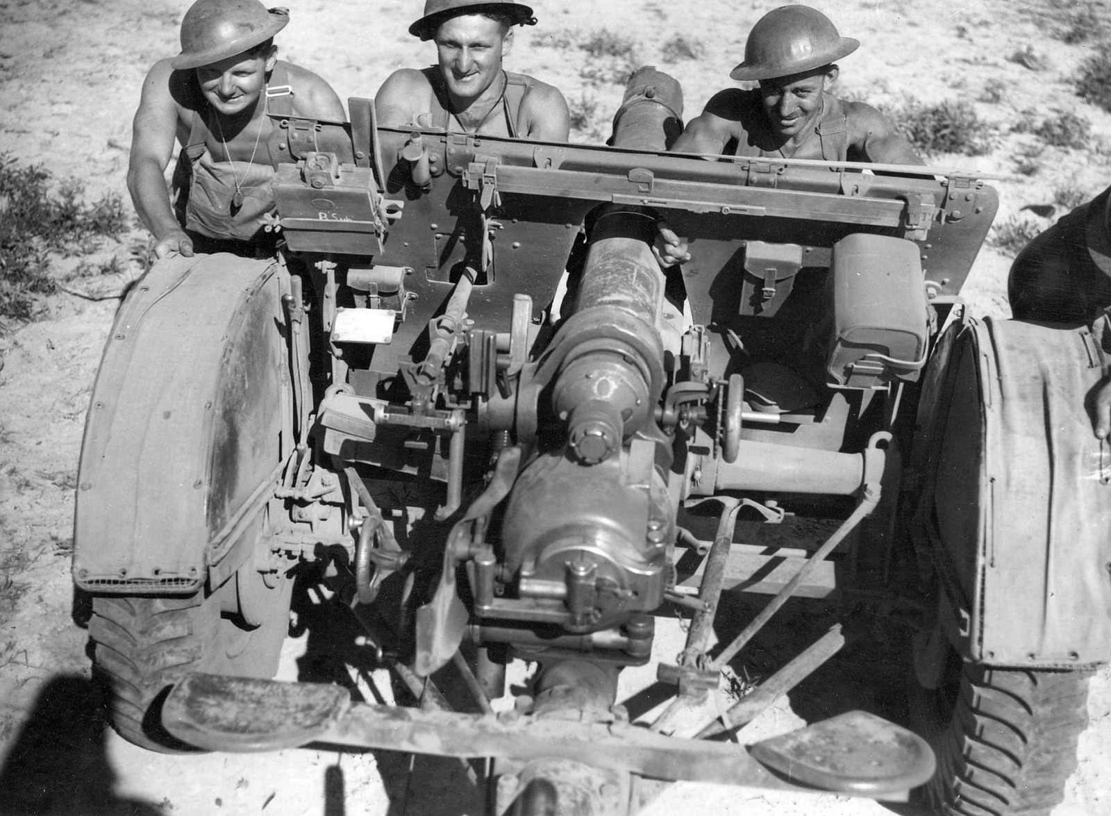

Mike K 02-08-23 15:03
Pic..............
Did you see this
http://www.mapleleafup.net/forums/at...7&d=1671514613
Graeme Stephens 02-08-23 16:23
Mike Pic
1 Attachment(s)
again another great info pic. thanks Mike. I like the 'Red arrow' - Gun TAC? sign 05?. ...... the 'Green arrow' shows my next re-riveting venture .... the 'White' setting key pouch project, making a mold, and finding a 17,18 or 19 Key haha ,
and there !! - ' Yellow arrow'. the thingy leather strap hidden behind the top plate.
Just noticed the Truck ? brake cable still hooked up near the number plate .... the trailer brakes aren't connected ?
Mike Cecil 02-08-23 16:47
D5 = the sub-unit tactical sign for the particular gun.
