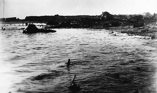

1 Attachment(s)
Another one that may be of interest here:
Attachment 116695
This is a still from the 1945 British Ministry of Information film Broken Dykes by John Fernhout (credited as John Ferno in the film itself). The first half of it is available at the Beeld en Geluid archive (so is the second half but it contains nothing of interest to this thread). In the black bar across the middle of the page, click the “play” symbol (the square with the triangle in it); the bulldozer can be seen at about 00:43:47:00, but only for a few seconds, and the film doesn’t show anything the still above doesn't.
Anyway, this is the dozer I labelled S55, most likely in late 1944, and it shows markings and other details I had never seen of it, because I’m not aware of any pictures of it taken as close-up as this one.
I’m informed elsewhere that the 344 with a diagonal bar behind it is the AoS marking of 1st Canadian Army engineers, which is slightly confusing to me, unless the bulldozers shipped to Westkapelle were on loan from that? Or perhaps it’s just that I don’t understand how all these units fit together (my interest is much more the vehicles than the units).
MicS 15-10-20 20:07
Excellent find, which gives us the unit of one of the Westkapelle dozer wrecks!
AoS 344c is 1st Mechanical Equipment Company, Royal Canadian Engineers. See http://www.mapleleafup.net/forums/showthread.php?t=4524

Jakko Westerbeke 15-10-20 20:34
Two wrecks :) The one of which there is a picture when it’s bulldozing in early November 1944, also has this AoS marking on the left rear, just aft of the Allied star. My conclusion is that this is the same bulldozer that ended the war on top of the dyke.
Thanks!

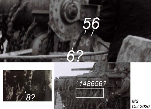

4 Attachment(s)
Back to the Memorial tank T148656, I am wondering about a marking which appears to be on the transmission housing.
It clearly includes a 5 and a 6:
Attachment 116890
and might have more numbers or letter to the left of '56':
Attachment 116891
I guess it could be its Reg No T148656 or just 148656, because the next sign left of '56' looks like it could be a 6 (next photo), the presence of a 8 before it being possibly the reason for what we see on the first photo above just left of the pairs of chains left of the 56:
Attachment 116892
In summary:
Attachment 116893
I think I have seen examples of the Reg No being painted in large numbers in this location, but naturally I can't find them right now...
Other photos of the front of the tank do not seem to show this marking, that is, on photos where the transmission housing is not obscured by the rounded guard plate between the flail jibs.
Any ideas?

MicS 22-10-20 00:01
2 Attachment(s)
From these photos shot while it was still in its (very faded) original livery, it seems that the marking was within the middle casting of the transmission housing only:
Attachment 116897 Attachment 116898
So, if this marking was indeed the WD No. and given the size of the digits, it must have been written in two lines:
148
656
Michel

Jakko Westerbeke 22-10-20 11:56
Now you point this out, I seem to recall noticing it before as well but for some reason not digging deeper into it. Chances are I forgot due to having all kinds of other stuff to figure out as well :(
Luckily you remembered, because I was about to go and find the one posted the other day :)
148
656
I’m not sure. In this photo:
http://www.mapleleafup.net/forums/at...1&d=1603308625
I’m not convinced the character left of the 5 is a 6. It seems to be missing its left-hand side and the remaining part appears too angular to me. I also can’t really make anything of the markings in the 1958 photos, as they’re really just a blur.
On the other hand, I have no idea what else could be painted there that would have the number 56 in it … AoS number 56 seems unlikely, and why would it be on the tank? (A replacement transmission salvaged from another tank is about the only reason I can think of, but see above.)
The 5 is a fair deal larger than the 6, as is most obvious in the photo with all the people posing in front of and on the tank. This seems to suggest it’s hand-painted.

A photo I don’t think I’ve ever seen of the tanks at ’t Stort:
Attachment 116970

Thanks for these new photos and the beautiful view of the MINOTAUR marking Jakko!
Your pic is a (much) better version than the old Beeldbank.zeeuwse (now digitaal.dezb) FO052990:
Attachment 116978
which confirms that when one can get to the original print (or better still, negative), chances are that many more details will appear than on the often poor scans originally posted. I downloaded this particular photo over 10 years ago, and it has not been updated for a better version since...
If the original pic of Dozer 'D' (FO039987) could also be located, we might find out its WD number and/or other markings.
Michel
